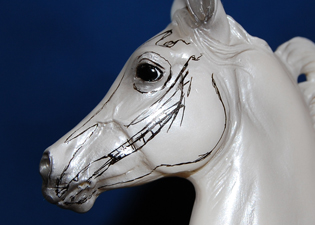

    Step 1 - To start we draw cut lines on model. Drawing the anatomy can help as well. Nutcracker looks like he got lost in the Nightmare before Christmas. This basically gives you a frame of reference for when you’re cutting. Try and make sure the cut is straight or else it will provide interesting challenges such as crooked jaws later for you to fix. For cutting I used a small hack saw but a dremel would also work well. I prefer hack saws for this because my cutting disks don’t like too thick of plastic and I wasn’t sure how thick Nutcrackers would be. Just a warning, Stone horses tend to have really thick plastic, this makes customizing much more difficult, so beware.
    The reason we cut the jaw like this is to accurately represent what is actually going on when a horse opens its mouth. See Tibbi Searchers article “Open Wide” in the RESS Technique Booklet #3. It is not just moving the part of the jaw that has the chin bit on it. The jaw’s joint is actually behind the eyes! This means that when the mouth opens (like a pair of scissors) it opens wider where the front of the muzzle is (where the point on the scissors are). Instead of having handles they have muscles and other connective tissue that create this movement. So just opening up from the corner of the lips forward isn’t realistic (although it is a common misconception).

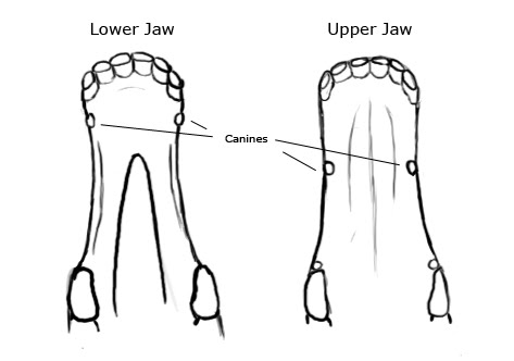

    Differences in the jaw size and canine placement
    For resins I suggest removing the jaw all together. I personally find it easier to re-sculpt the entire lower jaw but some people may prefer to add the details in to a carved out jaw (resin is lovely to carve into) and replace that later.
